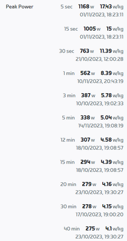

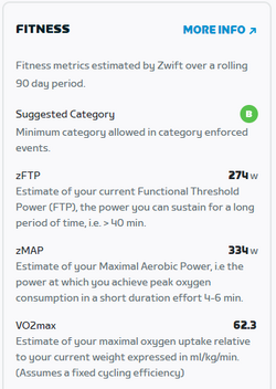

These are my numbers:
So the zFTP appears to almost exactly align with 40-minute power. And the zMAP with 5-minute. It even says so in the descriptions. And I think the category is then calculated based on these two numbers. I think.

Well the zFTP is meant to be a calculation of what you can do for 40 minutes + but it's calculated by some algorithm based on various power numbers from 5 minutes upwards (I.e not just what your 40 minute power is). My zFTP is 13 watts lower than my 40 minute power and zMAP 6 watts lower than my 5 minute power.
The category is based on zFTP and zMAP yes, but how they get to those figures is more complicated. And as I said earlier for some people increasing your 5 minute power can actually lower your zFTP.
Wit that in mind and with the fact that 20 minute power is no longer directly responsible for categories it looks and seems like more people are staying in Cat B for longer than would have been the case before. Not saying that's necessarily bad, just different
