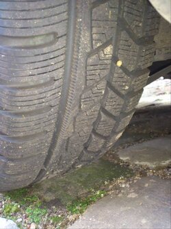

Maker of Things
I have just had two tyres replaced during a service. One was punctured on the edge of the sidewall and the other was just getting near the limit so I decided that it was worth changing them.
So now I have two Avon Ice Touring 205 55R16 now on the back, non drive wheels, for the time being. The fronts are still on the previous Dunlop SP2000 as they are still good for maybe 4000 miles or so.
The idea is that the Avons won't get as much wear on the back for now and I can swap them to the front when it gets properly cold and then change the Dunlops when they are more worn.
I don't know what they are like in snow and ice yet but the chap who fitted them use them on his own car and sells a lot of winter tyres due to the amount of hills local to him.
I asked for Vredestien but he said there is along wait for them as there is a high demand and they are appeaing in ones and twos as they become available.
I guess that means they are popular.
If I could afford it I would have an extra set of wheels and run summer and winter tyres.
