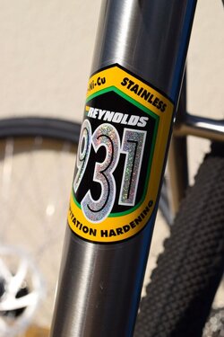

I also replaced the 531 stickers on my Carlton, the frame transfer had been ruined with a pump and the fork decals were incorrect, these replacements were painfully expensive, but are correct for the 1979 model year.
Did you go direct to Reynolds? I got a 931 decal for a £5-50 (not sure if the sparkly ones are more expensive), with every extra decal £2.
Gunk
Oxford
Didn’t even consider that, mine came from Belgium.
