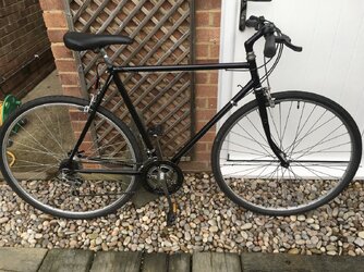

As you say, a bike for the purpose. My 70’s Dawes build is perfect for my commute and pootling around town. Would I go any distance on it? No, even though I spent some of this morning adjusting for stretched gear cables and juggling with bar angle and seat height. Fist, it’s a tad small for me, second, it’s flat bars and bare bones. If there were any less parts on it, it would not qualify as a bike :-)

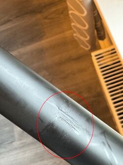

checking the bike over for tomorrow and noticed a paint chip under the seatpost clamp so i pulled the carbon post and noticed the post have a groove in it where the gap in the frame is , eek !
checked the frame and it looks ok but i had to rummage through the spares bin to find a suitable seatpost , all well and good but its too long so i had to saw it down then file and sand the edge smooth.That done i installed the replacement post and set it up making sure the seatpost collar is at the front rather than the back to even out the clamping force .
The frame looks ok but i am going to keep an eye on the carbon frame to ensure nothing untoward happens .
Fingers crossed for you that it's fine with the replacement seatpost. Sounds like you may have had a lucky escape there (potential snapped post).
cyberknight
Not my piccie but it looks like the below , i have read eslewhere its a known issue form slightly overtightening and wondered what other peoples thoughts are on safety? i did sand the bump down and cant see any cracks etc on mine
I've got the same issue with my Cannondale Synapse, it's been like that for ages and looks like the outer layer of the carbon post has distorted where the groove in the frame & clamp meet. It's been like that for years to be fair and hasn't..... er, don't tempt fate :laugh:.
i had to put the post back in until i get get a replacement as my spare post was a zero offset and i cant get 4 cm behind BB which is my normal measurement for saddle nose

Busy day. Finished a Dawes Discovery 201 refurb (grease bearings; free off rear mech & replace cable; fit 2nd hand brake blocks; ‘true’ wheels; fit rear reflector; lube cables) and add tyres from my ‘rat bike’; tried to replace them with two 27” wheels & tyres to find the rear wheel off-set and no easy way of correcting. Next step Wolber 700c and 37mm tyres, but not today.
