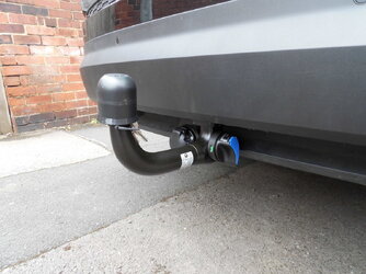

In the 2nd image, the holes, that could be used for a cable, in the 'receiver' are by the mount for the 13-pin socket (to both sides)

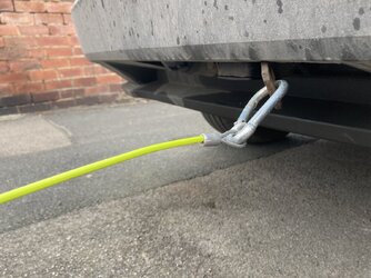

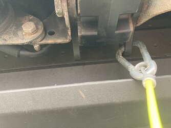

I've just been out & taken this duo of photographs
A spare cable clipped into the (self-fitted) point, on the 'receiver'
Clipped into the holes on the main part of the tow-bar
It's part of the assembly that the 'receiver' (or fixed hitch) bolts into, it's a long way back, & a 'on your knees' to get to it
The plastic seen is the cover in the 'receiver'
It's too far back for the breakaway cable not to be taut on a sharp corner, & could possibly apply the brakes??

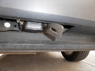

Was out at the caravan today and had a proper look. The Kuga has a proper metal attachment point for the breakaway cable. I’d thought it was the stop for the fold down electrics, but looking from the side shows the hole for the clip to go through.

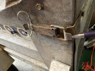

Oh!, & it’s a lot quieter since l bent/tightened the brackets on the tail-gate, that the over-centre clips latch onto
