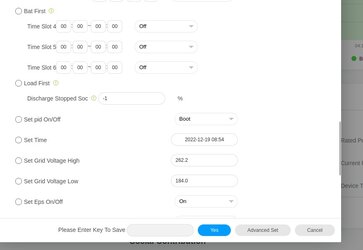

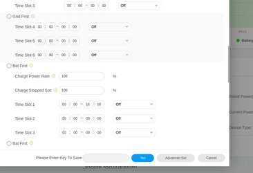

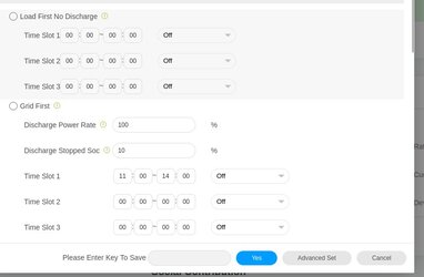

No idea of Fox, but my Growatt inverter/charger has a panel where you can decide where you want the PV current to go, mine is on load first, so we use whatever we're producing & then only when what's coming in exceeds the the load does it go to the battery.
There is another panel you can go to to change all of this, do you have something similiar?
I can change it to "Force Charge" on the app which will, if necessary, use the grid to charge the batteries.
Not normally relevant to us but useful if you have cheaper energy at certain times of the day
Of course, with the windter saving schemes it could be useful
And I think the installers tried setting it at one point but it doesn;t seem to have charged the battery
I would assume that the BMS would also use this to trickle a small amount of charge into the battery in order to keep its charge level above critical
But this seems to be the area where the fault is - the batteries just don;t seem to charge!
