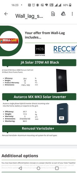

Just had my quote from the council run solar panel auction.
6.5k for 12 panels etc

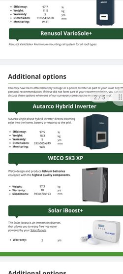

5k for a 7kwh battery or 6k for a 10kwh battery.
Doesn't sound too bad to me ?
12 panels of what wattage???
Warranty is 10 years on workmanship and products.

Just out of interest I stuck my details into the East Suffolk Council linked supplier earlier today and it came back with the follwing quote
I don't know the size of the panels, their output or the size of my roof before anyone asks, but a later quote using a different email address and a guessed roof size of 6m x 3m suggested 6 panels with a total price of abour £8300, but I didn't save that one andthe house is ESE/WNW orientated.
I'm not sure it's worth it being a very low user - even in winter I'm only using about 160kWh per month, although this will probably increase now I'm part retired.

Im a low user like yourself at between 150/160kwh a month……but its the price of those units a month that convinced me in the end to get a 3.2kwh system put on the roof, but no battery. The system will cover daytime loads and any excess sell back to the grid, to offset evening and nightime use. I went against a battery for now to keep the costs down.
