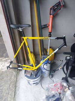

That's what I thought I was looking at my dawes audax frame it has a different geometry than the genisis I thought if I changed frames would I need to seat to be so high as yhe one on my genisis as its slopes a bit. Then I wouldn't have to have such a high stack what do you think?
cyberknight
where did you get the genesis from and have you checked the measurements ,? i am not saying its wrong but it does look small to me as i have been misold frames before now .Hard to tell without comparisons and i always end up on bikes that are on the large side of my sizing as im 5 foot 7

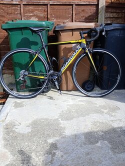

This was my current summer bike

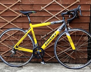

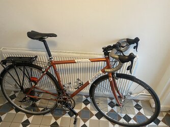

FWIW here’s my Genesis. I’m 5’9.5, long legged female, that’s a 54cm with a 100mm flipped stem and slight layback post. SRAM Rival 10 speed. 38cm bar. Works for me
ahh the seatpost looks long as its a compact frame which was hard to tell from the OPs 1st post , fair enough im just trying to eliminate the obvious first .
my giant has a lot of post showing but has the same set up as the boardman
