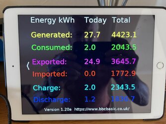

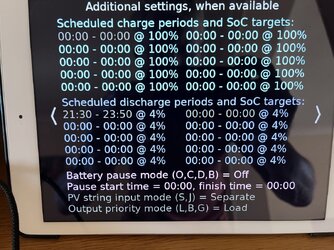

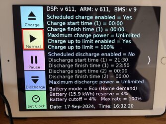

It surprised me how little energy the washing machine uses apart from the time when it's heating the water and thats not much. The volume of water is quite small, and washing at 30 degrees needs less energy. I have an iPad monitoring real time energy usage ( updates every 10 seconds ), the air fryer heating element is constantly switching on and off to maintain the set temperature, similar when we run the bread machine.

What are you using on the ipad to monitor energy usage?
It's the free " Inverter " app from bbcbasic.co.uk. Four simple pages, that allow some measure of basic control, Charge, Discharge, Pause, Normal.
Written by the guy who wrote the BBCBasic language for the original BBC home computer ( if you are old enough to remember)
Ah I see - you have a GivEnergy inverter.
