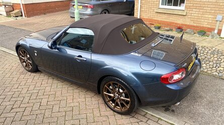

Wheel colour suits it @sevenfourate
Thankyou 🙏
I had them done in that colour (Fiat Donatello Bronze). Above: is actually an old picture. I’ve since had a Dark Tan roof too. Kind of got a theme going - as the leather inside is about the same shade….
