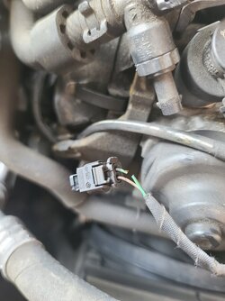

Just had an engine management light come on, scanned it and it's the fuel temperature sensor (VW Passat). I can see why:
Any ideas how to repair? There's barely any room to strip back and solder. I've got a replacement sensor but it's the connector unit that has failed

There should be enough on there to solder?
I've tried, i don't have anything to hold it with, nor anyone to help me. Also the pic makes the exposed wire look longer than it is. I'm trying to see if I can get a connector with pigtails so I can splice it in.
Get two small crocodile clips, then join them with a bit of thick gauge copper or steel rod in a U shape. These are your extra hands to hold the wires in place whilst soldering.
