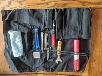

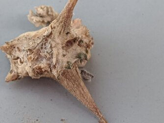

Wafter, you are obv iously infected with the Brompton disease. The one where obsessive Brompton tnroughts occupy your every minute. When I first was assailed I bought and setup an SA 177% IGH. Then a Shimano BB, a Chris King Gripnut headset and cork Ergons with bullends. A very narrow Velo Orange leather saddle was necessary as was 110 BCD crank arms with 38 and 58 tooth chainrings. 2 way Shimano SPDS are on there too. I first converted the original 1 speed hub to a 2 with a chain pusher and then BikeGang gave me a demo 11/14/17 one piece sprocket set. I have also made or cobbled up 3 front bags and a seat bag too. The damned goat head stickers that infest the American west "made" me make a tool roll with sticky patches, 15 mm wrench, steel tire irons, 6,5 and 4 mm Allens and an extra inner tube. Brompton ownership,is a slippery slope, my friends....since all that wasn't enough in December I bought a P line although that is stock except for Ergons, 2 way SPDs and bullends and, of course, another seat bag. Even though it is heavier than the P line the old one is faster because it is geared to 84 gear inches instead of 79 with the P line. I will prolly bite the bullet and go with 2 chainrings on it at some point. Pics of goathead and tool roll.

Sounds like you're really been down the rabbithole with yours! Those goat heads look properly nasty - I guess if you hit one of those it's game over regardless of how "puncture proof" your tyres are..
