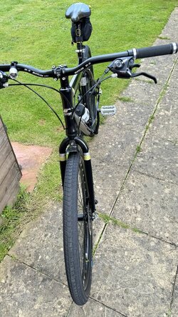

I’m running a Hybrid with 27.5 x 1.95” tyres. Used 95% on road. And have suffered a few punctures recently.
I now have Schwalbe tyres on - with puncture protection built in…….AND a 1mm Kevlar type tyre liner too.
This morning i adjusted rear tyre pressure (Upwardly) after not riding for a week. Went to go for a ride a few hours later and it’s completely flat. WFT ?? 😳
I don’t fix flats currently. I just change tubes. Possibly because of that I’ve been buying cheap. I looked at this last (Nearly new !) tube and it had blown at the seam. I dug the last one before that out…..knowing that deflated quickly too……and again; turns out it was a seam failure.
So:
1/. It appears cheap tubes are most definitely not a ‘thing’ that’s needed or indeed help in any way 🤦‍♂️
I will be doing research. Making sure I’m buying better quality and seeing if any of the MTB tubes are rated for higher (Road type) pressures.
2/. I’m 15 stone, bike must be 13-14kg, 1.95” road tyres being used, it’s use is on tarmac: What pressures should I be running ? [.**I think I may have been excessively high]. Which my low quality tubes definitely haven’t enjoyed either…..🙄
Cheers 🙏

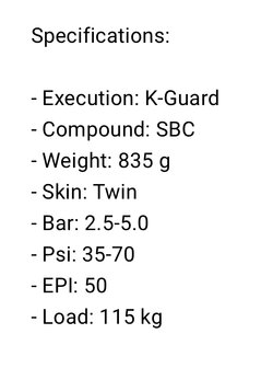

I’ve just been out to look. As I Googled above: tyre says 35-70 psi *Btw: many MTB tyres are in inches. Guessing you’re a roadie / 700c guy ?

***I’ve been running 80psi with them…. Tyre data below:

Hi - your tyre data states a PSI max of 70 yet your are putting 80psi on them. Have you tried reducing pressure to 70PSI?
Morning back at you.
No i've not if i'm honest. I think the PSI they state on the tyre will have some built in safety margin. And many people run road bike tubes at way higher than either of those pressures. I can see or anticpate no abnormal mis-shaping of the tyre due to running 10psi higher. And the issue's i'm having now all appearto show a pattern of occuring on the non-tyre side.
Do you have any other thoughts; on something that may be occuring due to the pressure im running ?

Are the tubes definitely designed for that size of tyre? If they are something like 28-35mm, then they will be stretched a little more than they are designed for in a 1.95" tyre.
And have you checked the rim while the tube is out, to make sure there is no sharp object?
People generally nowadays tend to ride at rather lower pressures than they used to, and though 80 isn't likely to be an issue, it would be unusually high for that wide a tyre. Even my 28mm tyres I only run at 80psi (Tubeless would be lower again). There was a time when the professionals would all be running at 110-115psi, they will all now be in the 80-90 range, and that will be on much narrower tyres than yours.
