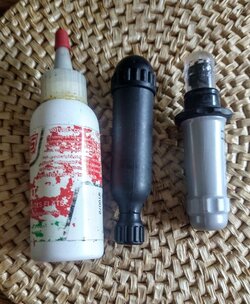

Small bottle of sealant and two alternative plug tools: Dynaplug and Stan's Darts.

I’ve tried worms and darts in the past without much success, Im sure there is a knack to it I don’t have. I do have both with me and there should still be some sealant in the tube so that could be a third option I suppose.

Yes that was my experience. I’m tempted to give the Stans dart a go first. Any tips other than stick it in the hole and keep everything crossed?
Ian H
Ancient randonneur
They are a bit fragile. I've broken a couple, which is why I got the Dynaplug (which I have yet to use). Main thing is to top up the sealant if there's been any substantial fluid loss.
