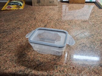

Re; the 'junction box', to bring the front marker-lights into the circuit
I used one of these, with appropriately sized holes (& that silicone sealer), a splash of black paint on it, to hide it under the body (& 'tie-wrapped' to the frame)
