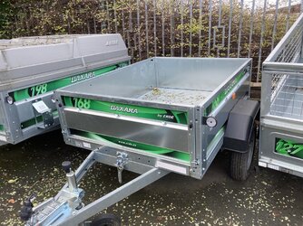

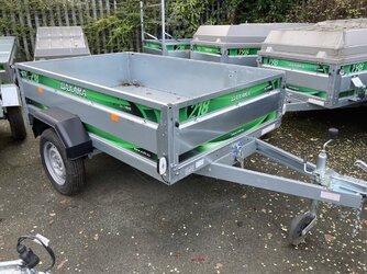

I have something similar - I fitted a jockey wheel when I replaced the one on the caravan - the old was was still good enough for the trailer so I bought a bracket and fitted it. Makes loading and wheeling around much easier and I can store it level too.
It has a clamp already fitted for a jockey-wheel
I'm going to Indespension (Leeds) on Monday, to buy new light-units, so will measure & have a look
I'm only going to buy these (cheap!), as replacement light-units; https://indespension.co.uk/rear-combination-light
Sunday 15th
On close inspection, & a wash (to see what was dirt, & what was staining), l realised it was slightly ’biscuit-tinned’, ie: twisted
(pick up a square tin, & twist it laterally)
I could ‘WD40’ every bolt & slacken them all off, & try to straighten it
It might, or it might not work?
That said, years ago (when l had the Discovery), l bought a new trailer from Towsure
I collected it built, as it was as cheap at that time to buy it assembled
Even ‘off the shelf’, that was ‘biscuit-tinned’, so if this is (at a guess?) 10 years old, it’s not an issue
(till wife notices, then it might be??)

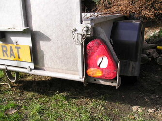

Likely an earth issue somewhere or maybe an LED bulb fitted?
The cover/lens is cracked (& I have no idea for how long?), so I'll be replacing both units
Why not not replace with led units??
I tend to think of trailer lights almost as 'disposable items'
Quite a few years ago, I managed to crack the light on my Ifor-Williams & through the backing too, by reversing then hitting a branch
Plus, I can replace both with bulbed units (inc VAT) for less than the cost of one LED unit (before VAT)
Because it’ll mess up the car’s trailer bulb failure detection system.
That's a reason too!
Some bulbs/units have resistors built in for that very purpose, I understand

We went this morning to Indespension (with a side-trip to the city-centre for daughter, so she could nip into 'Trinity Centre')
Unfortunately, they only had one light-unit, but spare lenses in stock
On arrival home, they looked identical, but….. there’s a difference of a millimetre or so in the size
That could simply be that the ‘bases’ have deformed slightly over the past few years?
For now, to save having to grind off seized mounting bolts off, l just put the lenses on
When l get another unit, l’ll sort them out. (& keep todays lens as a spare)

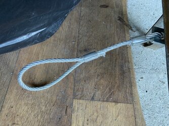

EDIT; Tuesday 17th @ 09:44
I also bought a safety cable whilst there, they didn't have any chain variants
