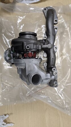

Not quite what i expected given the timescale but the first big job will soon be underway.
Book time for just the turbo is 12 hours :rolleyes:
Now it's just working out where to draw the line with cleaning and looking at other components whilst it's off.

Can I book mine in for whistling turbo!!
Hopefully yours is a little less time consuming with no DPF and it's position. On a plus, your engine type should be relatively inexpensive for a replacement turbo.
Have you checked for boost leaks or cracks in the exhaust?

No it's fairly constant so I didn't think of that? Not like a boost valve.

Crack in the exhaust manifold or the exhaust will allow a constant whistle, even on tickover to some extent. High pitch whistle likely to be a cracked exhaust. Low pitch whistle likely to be a worn turbo
