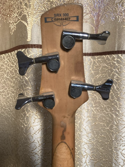

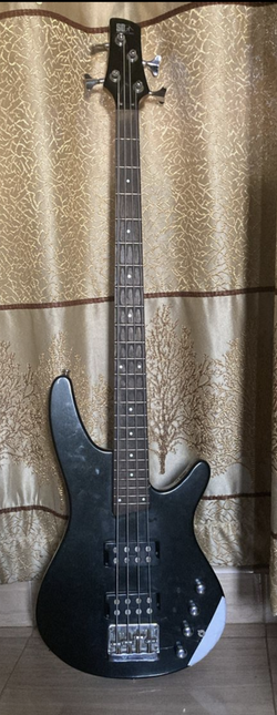

What do you reckon to this guy's? Is that scarf joint going to go on this 2002 Ibanez SRX 300?

Can't see it's splitting but looks like it's rather open. Haven't bought it yet but I don't think it's worth chancing. There's also some damage which has been covered up by plastic on the bottom of the body.
Shame as apparently they have quite a unique sound.
