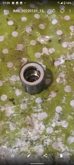

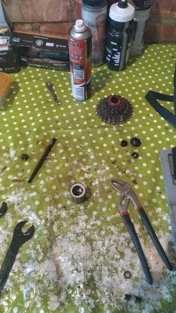

As an aside I opened up the hub and the picture below shows it set up , I've cleaned up the pawls and the rest but does anyone have advice about the rest of this hub in terms of maintenance
You generally need to do very little with these Mavics. Only thing is to ensure the bearing is running smooth, if you can get to it, pop the seal off and grease. If not, you'll need bearing removal tools. The nylon bush can wear and 'howl' but a clean up and some light oil can fix them. Otherwie it's replace the 'bush'.
