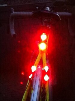

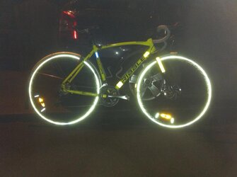

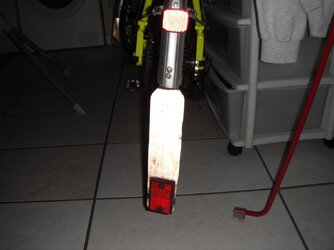

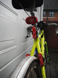

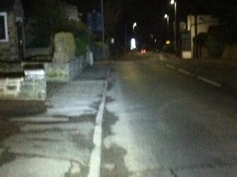

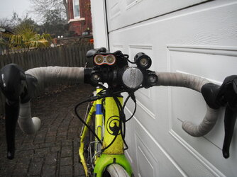

LIghts & reflectors
The CGR frame 'died', but barring the reflective (frame) tape, all lights/reflectives are the same om the Biscuit
Just iPhone flash.
