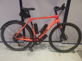

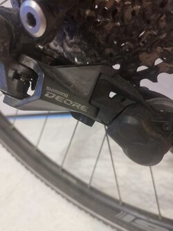

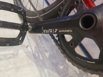

I have just weighed my bike (Kinesis) and it's 13.1 kg

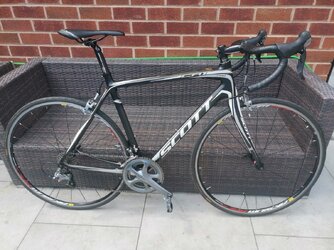

Just to get used to racing bars (or whatever they are called) I bought another bike 2nd hand (Scott CR1 Pro), which is full carbon and the weight it 8.2kg so much lighter.
I suppose I want the best of both comfort position of Kinesis but as light as the Scott.
Why do I want to buy another ? Good Q but I think the Scott is old now, and the Kenesis has a fair bit of value currently, which I can rotate/maintain with a new bike, otherwise it will only reduce in value. Besides who doesn't like getting a new bike :smile:

I don't want to alarm you, but judging by the pic, I think you might have too many spacers under your stem. Columbus, the fork manufacturer, specifies that "there is no more than a 40mm distance from the top of the upper headset bearing to the bottom of the stem". In the case of the Kinesis Range fork on my ATR, I had 50mm of spacers when the warranty specified 30mm. A flipped stem might well be enough to get you the same bar height with a warranty-supported number of spacers.

Thanks but I think the bike is out of warranty anyway. Also I didn't buy it new.

Ignore the warranty, the point is, if its a carbon steerer, which these chaps think it is, too long a piece of steerer above the head tube means the internal compression clamp is all clamping to steerer external of the head tube, which makes it more vulnerable to snapping with potentially fairly catastrophic consequences for you, unless youve fitted an extra long compression clamp
not quite illustrating it but you get the drift....
