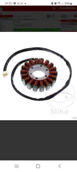

Both look like Chinesium copies, the stator even has some marks on it where it looks like the magnets were actually touching the copper windings, all 3 wires have a route to earth.

Yeah a 2008 Sprint 1050, the regulator is directly wired to the battery via a fuse, but don't think it's a MOSFET but I have no way of knowing. Not sure if this is not the opposite way around as you can see on the 3rd image the magnets have clipped the windings.

Yes the flywheel has rubbed on the stator windings which probably killed it but if you are in doubt about the Regulator (Chinese) best off replacing the pair imho.

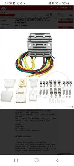

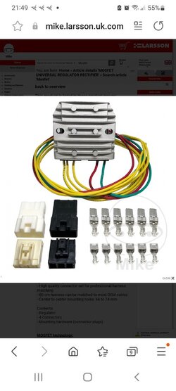

These are what I fit now, if money allows, they place less load on the stator and do not heat up in operation (a "normal" regulator sheds excess output from the stator as heat), these only take what is needed from the Stator keeping both under less stress.
They stator on your Sprint is designed to be run in oil.
I personally crimp and seal all the wiring as the connectors are another failure point but if you have all new kit then should be fine.
Post a picture up of your Regulator, I'm positive Triumph are Shindegen, SH plus a code on the top (same as Honda use).
A JMP Stator is around £130, they aren't bad quality to be honest.

I'll get you an image of it later & post up, I intend to do this only once so good quality stuff even if a little more expensive is fine.
