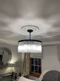

I'd be very anxious holding up 17kgs with toggle bolts through a ceiling😯
I was nervous as well, so not bothered . Managed to get a coupe of fixings into joists . Seems quite sturdy now !
Not asked the Boss how much they were but they look nice . Two of fitted

Well I’ve got a job to do with fitting new lights. However it going to require getting under floors and strengthening with wood. She’s bought small chandeliers, coming in at 17kg !!! Ffs
Strangely enough last week I fitted two of these, they have 12 bulbs! Fortunately I managed to work out where the joists were, so managed to get two of the four screws into them and it all seems solid enough. I did use the new fangled electric connectors, rather than terminal blocks and they make joining wires so much easier. There are two sorts, one where you just shove the wires in and they are then gripped and a reusable sort which have a small lever on them which traps the wire. Very much recommended for all electric jobs.
