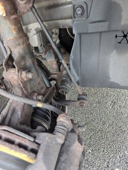

Mrs Bs 'onda Jazz has today failed on her with a sudden loss of drive in gear.
With the clutch disengaged all is normal, however engaging the clutch in or out of gear gives no drive and just a bit of a thump thump thump noise a bit like trainers in the washer.
Clutch pedal feel is fine cylinder and fluid look good, looks like something inside.... one for daylight hours.

Now daylight has arrived and the snow has diminished I have had a chance to have a closer look.
I think I have identified the problem....
Tom B
Lancashire
Ordered the part, £95 delivered tomorrow.
I can only assume it's the awesome power of the 'onda Jizz and the fact she drives it like it's stolen.
Still awaiting parts but the axle side came apart easily enough, snow stopped play on the gearbox side.
I'm just a little apprehensive about getting the other side out without buggering up the oil seals. Apparently a smart whack on the back of the CV body with a drift should set it free and keeping the car jacked high on the OS will be enough to keep the gear oil in the box..
Handily the nut was 32mm so I had a socket in the bike tools box!

Tom you should maybe get a new driveshaft oil seal before doing the job. Replace it, don't think it will be that difficult or an expensive part. You don't really want to put a new driveshaft in and find it leaking, then have to take it out again, top-up the gearbox oil again etc. Just I had a Nissan Primera years ago that a garage changed the clutch, must've damaged a driveshaft oil seal removing one of the shafts. Next time I went to use the car found a small pool of gearbox oil underneath it. Wasn't an issue as they replaced it for nothing. Maybe a bit of a pain if you have to do the job twice in this cold weather.
CXRAndy
Lincs
I use a pry bar to pop the shaft out of the gearbox. Or you can buy/make 'U' wedge to fit between CV and gear casing.
Edit good idea to change oil seals -sods law they will leak after doing the CV shaft replacement
You will have to tell the wife to stop dumping the clutch for drag starts :laugh:
My wife's favourite trick which caused a little damage was to literally jump across a set of railway lines. The road tipped up and she would take the kids over like going over a hump back bridge. The Audi dealer said we had oval alloys :laugh:
Tom B
Lancashire
That's pretty much what happened with my other car. Had a new clutch put in it and the local clutch god reckoned someone had been in it before and messed the seal up, still weeps because midncoviditus we couldn't get a new seal (£7) and I haven't got around to it yet.
Local onda main stealer isn't the best with parts and are trying to figure out when they can get one. £14 + VAT. Experience tells me it's pot luck if it's the right one and they won't take them back without a battle.
