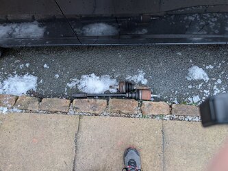

Driveshaft be changed..
It was a bit awkward getting the gearbox side out due to.the engine mount being in the way but I got there.
Didn't replace the oil seals due to the Honda Parts department being rubbish. I did mark it with the drift but fingers crossed it's okay. If it does weep it's only three bolts (and wheel nuts) to get get to it.
Of course now I've fitted it, I've seen loads of bad reviews for the driveshaft supplier, but hopefully they're from people running exotic limit pushing set ups in performance cars.... Not Honda Jazz
