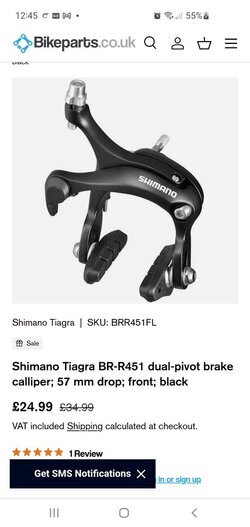

I think I'll buy this ......

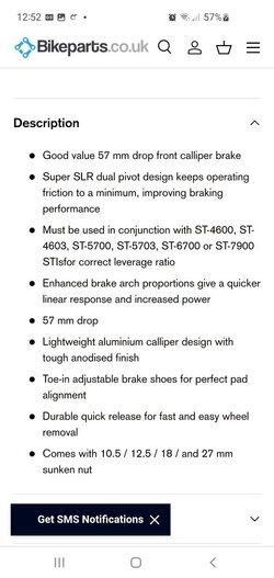

What levers do you have? If 105 then they are the 5xxx series.
figbat
Former slippery scientist
So it seems from brief googling that 5700 and 5800 have different brake pull ratios, but I do not know which way around. You will either have a very short lever pull meaning sharp brakes or you will have a long lever pull meaning lots of travel with the risk of bottoming the lever on the bars.
