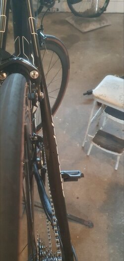

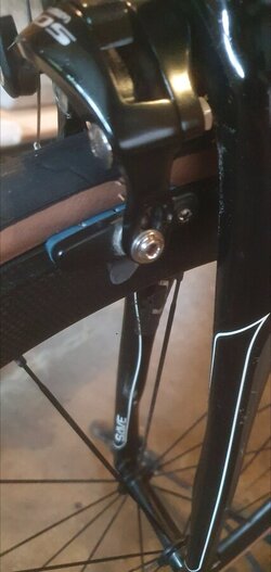

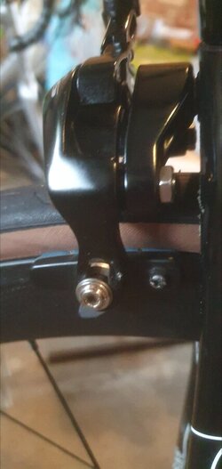

Hi All I've noticed my 105 pads are ever so slightly touching the rim of the tyre it's only on the front and on one side and I've lowered them as far as they'll go in the bracket

Is the wheel seated correctly and not sitting on the lawyers lip?
Ajax Bay
East Devon
Be aware that riding them like that will result in abrasion of the sidewall and eventually slight tube protuberance, followed invariably on a steep downhill by an immediate deflation which on the front may have 'consequences' (and not just needing to boot and replace the tube and gingerly make it home). DAMHIKT (x2)
I bought some 105 brakes (on here I think) which looked dead smart but when I fitted them I had exactly your issue, so reinstated the originals, which had that extra few mm of reach.
Apart from replacement, the best thing you can do is use new pads as this pushes the caliper arms apart and makes a mm difference. It may be that the pads currently have minimal wear, in which case this mitigation route is null.
Vital that the pads are precisely tangential.
But as the pads wear down, beware.
The other thing you can do is to pare the top edge of the pads, narrowing them (so reducing contact area and efficiency) but at least they won't abrade the tyres.
J

Cheers good points there I've seen a video of someone file out a couple of millimetres from the bottom of the bracket they sit , any thoughts on that ?

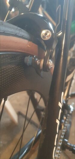

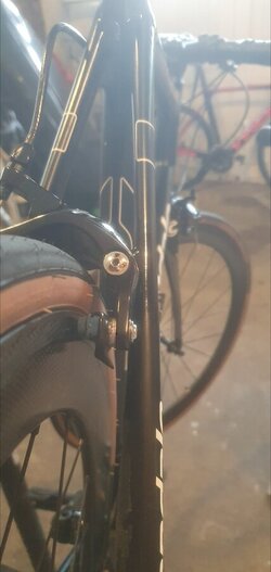

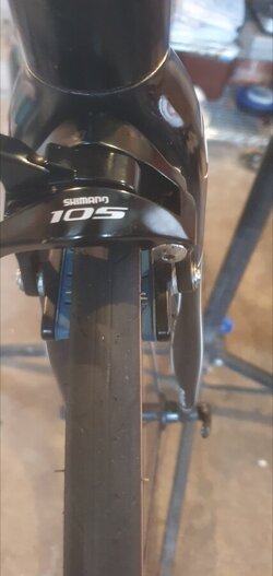

There's what the rear pads look like

screenman
You could do that, not sure what it would do strength wise though, not a lot would be my guess.
