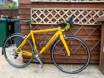

I'm guessing it depends on the saddle many modern ones are quite flat so a level saddle is ideal.
However many such as charge spoon, rolls, turbo, brooks have a bit of shape so the back bit needs to be slight uphill!
If you get any numbness then the position is wrong tilt it forward.

indeed i have spoons ...
