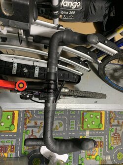

Having messed about converting the bike to flat handlebars I discovered I didn't like them. So, having tried the continental style touring bars earlier in the year and now these bull horn type it seems drop bars are the only type that my arms are happy with.
So, yesterday I did more messing about fitting the old drops back on. Checking the gears I noticed some bobbing in the rear wheel. Had my increasingly fat arse finally squished it?
This morning I dug out the wheel truing stand and checked. Nope, still as true as when I built it ^_^ The tyre just hadn't been seated properly. Checked the front wheel too while the stand was out. It needed a slight tweak.
Noticing a ticking noise from the rear wheel I decided to strip the rear hub. Ugh. Mirky much? Cleaned, regreased and rebuilt. Running super smooth again. The same can't be said for the front hub which is sounding a bit groggy. Sealed bearing type crap so will wait till it dies and just buy a better hub someday. This'll be the second SP hub to go on me. Rubbish.

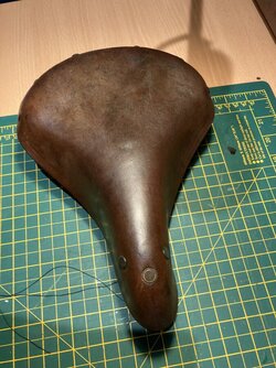

Bought a vintage French (non named) saddle for a tenner yesterday at Newark Runway Monday Antiques Fair and as they say up North it was as dry as old sticks and warped out of shape. A damp down plus a string wrap to reshape it and after an overnight slow dry away from direct heat I applied a generous coat of Vaseline and melted it in with a hairdryer. Result - it’s practically an arm chair in its comfort rating.
