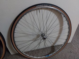

Firstly I had a go at the Kingpin. Shortly after getting it I discovered that the front hub had probably never been serviced. What little grease was in there was like glue and pretty much the whole bearing track on the cones was pitted. At the time I just regreased to keep them going but recently I took a punt on the cones from a hollow axle conversion kit being a decent enough match to work. The cones
are ideal but unfortunately I hadn't banked on the original axles being a smaller diameter than the 9mm standard. I had a suitable axle and the fork dropouts needed some filing to make it fit. After an adjustment to the rear hub as well the bike felt smoother to ride on a short test and I look forward to trying something a bit longer in the near future.
