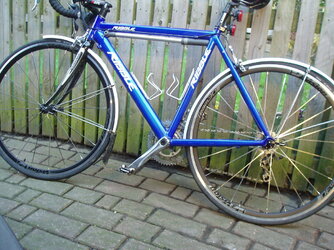

Thus yesterday, meant getting its predecessor out of the shed, for the ride to work (I was on a 10:00 - 17:00, so no need to swap lights onto iI
Ie, this;
638703
As the CGR's mainly a work-bike now, I don't get out as much as I'd like to, for a longer ride:blush:, I just ordered a pair of 'Never Heard Of Them!' wheels from Amazon
(ordered on Sunday evening, they were here when I got home at 14:30)
The longest part of the swap-over was finding my bottle of thread-lock for the disc-bolts
638704

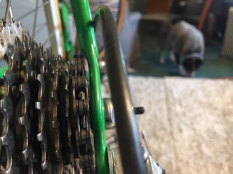

I couldn't fit my 7-speed freewheel on my '80s vintage Specialized training wheels, so I bought a new rear wheel. Now it fits, barely. Had to put a washer under the derailleur to keep the bolt from sticking out. Proper part (hopefully) is ordered.
With this wheel, my 18-speed is now a 21-speed. I collect speeds...

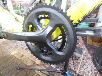

Chain-rings off; I know that one threading was a bit suspect, & I was careful the last time I had the rings off (about a fortnight ago), but it has lost that bolt:rolleyes:
Thankfully, I have a spare chainset, that I'd bought to get an inner-ring, after previously bending one, & it was cheaper to buy the entire unit, than a separate Tiagra '34' ring at the time, so it got a new '50' tooth ring
I had the same problem a couple of years ago, replacing the inner ring on Tiagra was ludicriously expensive, so I replaced it with a Sora R3000 inner ring - there is no difference that I could discern and cost less than a tenner. That same 34t ring is now doing service with a 105 chainset that I changed from 52/36 to 50/34 and I can't tell any difference on that either.

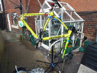

You waxed your frame! Why?
Well I’m into car detailing and have many polishes and waxes.
I enjoy the process and my frame paintwork is squeaky clean,shiny and water will bead off now 😂
