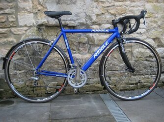

Ribble refurb completed yesterday afternoon. Everything refitted, greased, lubed. All bolts tightened. Spare saddle fitted, also Keos on loan from 'old' winter bike. Temporary bottle cages and longer stem fitted (both post photo). Test ride great - quiet, smooth, and free running - just like a new bike :thumbsup:. Soon got used to the Tiagra shifters - my 'summer' Ribble 7005SL is all Campag, and the 'old' Peugeot has downtube shifters. Will swap the saddle later, fit new bottle cages and a new 12-27 or 28 cassette, to replace the existing 12-25.

After about 30 miles 'running in' rides on the 'new' bike this week, exchanged saddles with the 'old' one and checked the set up. Adjusted position to match the measurements of my other bike (same saddle) - centre of bottom bracket to top of saddle, nose of saddle to c/l of stem / to c/l of bars / to hoods. Checked saddle was level, and marked KOPS position on top tube for reference. Tweaked mudguard clearance and checked all bolts for tightness.
