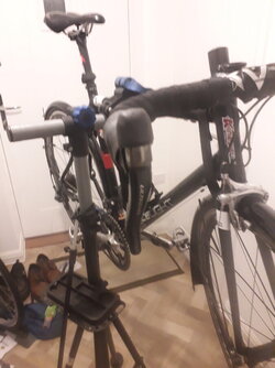

The current learning experience on the bike stand:
This will go for a fairly low price; I'm learning how to set up this kind of bike because we have a stack of older bikes with centre pull brakes so I need to work out how to fix them. As I don't have a Third Hand tool, I clamped the brakes shut with a woodworking clamp and pulled them straight with a mole wrench, which was moderately successful.
The rear brake isn't great, but after a few useful tips here, I'll have another crack at it on Monday.
I have taken them completely to bits before now and I do realise you will not have time.
It did then make adjustment so much easier, as well as the better brakes I was after. Before that as long as they moved easily I always considered the pivots to not matter much as there was a lot of leverage.

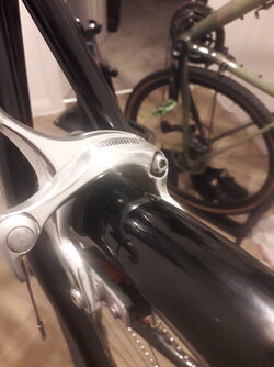

Changed that lever this afternoon and whilst I was at it I put new pads in the rear brake holder. Lol, the retention screws came out easy and I thought I was on to a good thing but the pads themselves took a bit of persuading.
