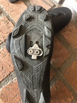

I actually prefer the amount of float offered by SPD cleats and pedals, I find it more comfortable for my way of riding. My heels were also striking the chain stays on occasion so I rotated the cleats to allow my heels to sit farther outward. This was a simple manner of twisting the cleat while tightening and also positioning it as far to the inside of the shoe as possible which resulted in the foot sitting farther outward when mounted.
These were only subtle changes but made a great difference to me.
my set up although similar has less angle on the cleats , i must have a less knees out stance :smile:
