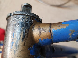

Would the lugs or frame number give any clue to it's origin?
The original colour appears to be gold, could i get the blue off & leave the remnants of the gold?

Peter Kohler has written about the Lenton, here for example but also on Sheldon Brown.wonder if your forks have been changed.
https://on-the-drops.blogspot.com/2016/12/the-raleigh-lentons-1948-1960.html
Thanks for the link & it led me onto this
https://on-the-drops.blogspot.com/2016/12/the-clubmans-1946-1951.html
@biggs682 is indeed correct, i'm sure it's a Rudge Areo Clubman c1951
the page tells us the following;-
Raleigh, Humber & Rudge only differing by their fork crowns
1950 chrome fork ends, chainstays & rearstays
brazed on Sturmey-Archer cable pulley boss
Bayliss-Wiley large flange Continental hubs, Dunplop HP Stainless steel rims
The revised Clubman also benefited from the new range of alloy shell hub gears introduced in late 1949 by Sturmey-Archer. Supplied "stock" with flip-flop fixed and free single gear, any of the Sturmey-Archer hub gears could be fitted at extra cost including those made specifically for club riding.
FIL Had the deraileur gears fitted & swapped to flat handlebars (& that paint job!), he says the Brooks saddle went in the late 70's.
Apart from that everything is as it should be.

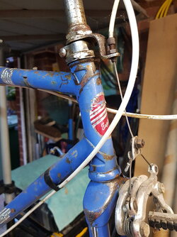

I was hoping the blue paint applied in the late 50's by FIL would come off leaving plenty of original paint underneath.
I've tried all chemicals, acetone , paint stripper, meths etc, it will only come off with a hot air gun.
The steerer tube does give a clue to it's former glory.
