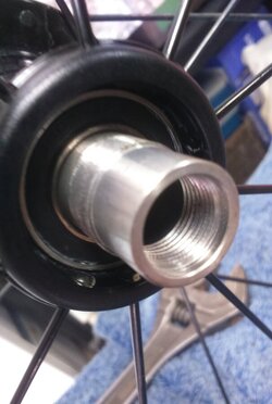

Well think this might be the right thread to post my question in I've Campagnola Kaminsan wheel set on the Planet X RT 58 road bike and noticed a couple of days ago I had about 1mm play in the wheel (this was when I fitted new tyres to it. I first though I'd not mounted the wheel securely in the forks but it to be the bearing, first. Thought it was a case of worn bearings which I found are sealed cartridge type but I adjusted the locking nuts and eliminated the play and still have a freely spinning front wheel am I doing wrong here as found the back wheel has about the same amount of play in it too I have done about 4000 miles on it as had since 2015. How can I tell if new bearing are needed and will I need to make up a bearing press and extractor for them have looked at the video Ido have access to a lathe so could get a bearing press turned up is it easy to got a sealed bearing extractor Any Ideas anyone many thanks
Well having stripped the freehub and axle from the bike can now see that the play in the wheel is between the axle and the inner ring of the bearing so do I need to replace the axle though I would have that the bearing would wear out first? also can't see away of stripping freehub from axle to check other side. Though that side of the axle and bearing seem ok.
