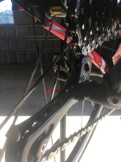

rliu - I am also having similar issues with my rear derailleur / cassette / chain.
I have a retro Campy setup - 9 spd, 53 x 39 chainrings and a 13 x 26 cassette. The cassette, chain and rear derailleur (mid cage) are new and 9 spd - yet in small ring, rear derailleur is making chain rub against cassette - mainly gears 1 and 2, and 3 isn't completely clean. When I mentioned about using a slightly longer B screw on rear derailleur, the LBS were reluctant to go down this route re safety concerns etc. So, will re-read the responses here to see whether there is anything which may help me. Thanks.

:welcome: Think it will be difficult to offer help unless you share a side on view with the chain in inner ring and largest sprocket (ie your lowest gear).
This is an entirely 'normal' set up and a short cage RD would be woman enough. So it suggests the (rotational) upper pivot spring (round the bolt to the hanger) might be malfunctioning.

Thanks Ajax B - will have a look and maybe mention this to the LBS as they weren't keen to start using different length B screws on grounds of safety - which is understandable. It's just that I have to make my current setup work, since I won't be in a position to buy a new bike anytime soon.

Hi Ajax B - forgot to post some pics - see attached of second gear (cassette: 13 x 26), mid (medium) cage RD which is 9 speed compatible. Gears 1,2 and 3 function but are noisey as the chain is rubbing. Any thoughts? Do I need a short cage RD?
