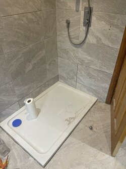

F it , I’ve cut the old flooring away as much as I can . Going to strengthen the joists properly this time unlike the clown that did it first. Then some 18mm marine or waterproof ply. I don’t want this floor to even move a smidgen ! See what I’ve got then with a dry fit , and I will cut the tiles away to get this thing underneath ! Take my time and hopefully all will be well .
Btw the noggin is not mine!! It will be coming out most likely and stronger ones fitted !

Well been at this for a while now, however floor was strengthened, ply down . Eventually decided to remove the lower tiles as I had spares. Which I found !! The only down side is the floor has a hell of run off to the drain hole on the tray. So not quite level . Hope the shower screen will adapt !? Chucked quite a bit of mortar under the tray at that corner to try and bring it up but it’s dropped !
Should be a bit of adjustment in your shower screen.What sort is it...as in does it sit in a chanel at the wall ?

Sits in a channel so hope there is enough ! Think it was first fitted with tray no1 at an angle so it did fit ? Will worry about that tomorrow. On another not Should of bought rapid fix adhesive , I could be grouting now lol
Just to report , all sorted and fitted . No leaks and it’s feels solid underfoot on the tray ! Hopefully that’s it! Now to sort the stand alone bath which is another clusterf….. with the plumber !
