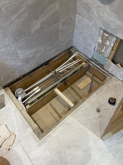

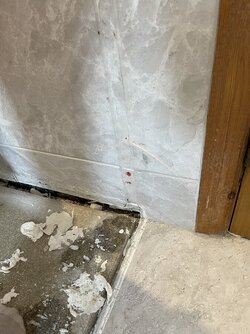

So this is our third shower tray all because Super Mario the world worst bathroom fitter ( recommended to us) , anyway I digress . Had to smash the resin shower tray along with the use of some power tools to get it up . Cracked a wall tile as well ! However have spares . My plan of course will be , to lay some new ply, screed the area till near level with the tiles . Then get some wet mortar mix down for the shower tray to bed down on ! It’s what should have happened first time ! F….Kin idiot . Only thing is tray will not sit under the tiles due to previous f up . Be fine though once I get the sika flex round it !

Can you not cut tiles with a grinder to make it fit snug ?
Possibly but not feeling that brave ! The second time it was fitted it was butted up against wall and it was fine once I filled it with enough sikaflex .
Mind you I have managed to cut out the cracked tile ! So might give it some thought ! Be a better fit !
However , I’d need to leave a big enoughgap to slide tray in and ensure all level ?
However , I’d need to leave a mouth gap to slide tray in and ensure all level ?
Ive every confidence in you....get the grinder out and make some dust !

F it , I’ve cut the old flooring away as much as I can . Going to strengthen the joists properly this time unlike the clown that did it first. Then some 18mm marine or waterproof ply. I don’t want this floor to even move a smidgen ! See what I’ve got then with a dry fit , and I will cut the tiles away to get this thing underneath ! Take my time and hopefully all will be well .
Btw the noggin is not mine!! It will be coming out most likely and stronger ones fitted !
