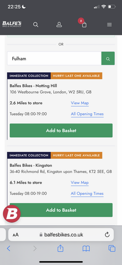

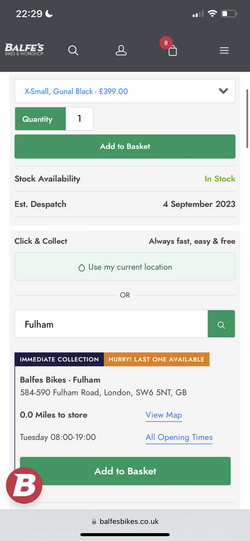

My LBS is Balfes, they have a good range of brands and bikes and plenty of stores around London. They have one in Fulham I believe. Trek do a step through stagger option, might be worth a look. They say they have one in Notting Hill or in Kingston (call first before travelling :smile:)
https://www.balfesbikes.co.uk/bikes...rough-hybrid-bike-2023-in-lithium-grey__12594
Their Fulham store has an XS Flourish 3 in stock too

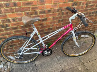

I think you'd be very well served by an older (late 80s/early 90s) non-suspension mountain bike with slick tyres. In many ways, these are the perfect bike for general transport with heavy loads (a child counts as a heavy load). They are not too sophisticated so easy to work on, they have decent brakes (in practice, for the type of use you're describing all modern bikAes have decent brakes) and they are strong, with compact, rather overbuilt frames which keep the centre of gravity down and are very rigid for attaching racks and child seats. Great for luggage carrying, which is why many people use them for round-the-world touring. That also makes them perfect for carrying children!
There might also be cycle training too, which is something to consider.
This is an example of a decent bike for your situation (albeit you'd want a smaller one). Something that looks like this is ideal. Ignore any labels of a "ladies" frame - engineering wise, there is no such thing as a ladies frame. Low step designs like this are practical for bikes where you don't want to swing your leg over the top.
Anything else? Yes. Mudguards will keep you and the kid dry and free of mud, and a lock will mean you get to keep the bike longer. If you have a new, shiny bike it is much more likely to be pinched, so you need a more expensive lock - another thing in favour of these older machines.
