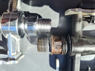

Not only that but could you look at these photos:
Old vs new. On the face of it the threads all look same size. But then once I've tightened it as much as I dare (as in I don't want to go like a maniac - been there & done that on the car too many times) -

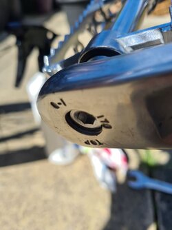

The hex bit is sat inside with some of the internal threads on the arm showing.
Now I can't remember how far it sat in with the old pedals. I thought it was flush but I could well be wrong.
What's your opinion of this? Does it look ok? Haven't put the other side on yet.

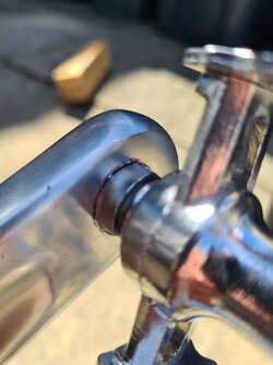

Pedal side of the arm. Looks like bits (coating?) of the arm is lifting after tightening that down?
FOR CLARIFICATION: I went with what was on beforehand in terms of orientation. In other words, the old pedal that was stamped R that my right foot would be on - that's what you see in this photo & is also stamped R.

Check you have them on the correct sides, they are marked L & R
Now that's out of the way ;)
Folks views on the above (photos)? Is it looking right or not & if not why not?
Really should've removed one side & then replaced that side so I'd have the other side for reference.
edit - put the old pedal back in. it was further in than the new one in the sense that it went more of the way through, but there were still internal threads showing when this was seated all the way home, just not quite as much.
I'm going to gamble & say for as close as it looks, it'll be right.
