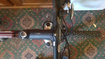

Thanks Norm, Im going to have a go this afternoon.
I have attached a close up image and have identified the Allen Screws you mentioned on the stem and top of the headset spindle.
Ill make sure the bike is upside down when I tackle it.
No, keep the bike the right way-up, just don't lift the front end when everythings loose!
You slacken the top cap, and then the 2 bolts clamping the stem to the steerer tube, gently rotate and when everythings in the right place, use the bolt in the top-cap to gently compress the stem and washers. A bit of fiddling here is required, because you need just enough tension so that when ypou tighten the stem bolts everything rotates freely without graunching or free-play. Small adjustments of the cap will then find the right position.
Good luck!

And if you can get someone to help, it is easy enough to do on your own but its a lot easier to get someone to hold something and stand back and check the wheels and handlebars are all straight when your done.
Norm
+1
+2 to FF and +1 to cyberknight.... is that +3 overall? :biggrin:
Do it with the bike on its wheels and don't lift the frame, or lift the bars when you are doing it. If you can get Mrs Sleuthey to keep a good grip on things (fnaar) whilst you are working, then so much the better. :thumbsup:

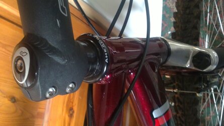

The use of an assistant was a good idea buit the actual job was much easier that I thought. I thought I was going to have to take the wheel off which is why I was going to do it upside down however it was simply a case of disconnecting the brakes. I did not slacken off the steering collumn by much to reduce the risk of loose BBs.
See attached pic.
