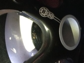

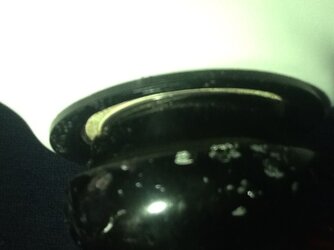

I can upload pictures but not sure if they'd show anything, is there a way to upload videos?
Edge705
Looks like an FSA chainset to me most likely alloy gossamer or the type anyway the bottom bracket is contained within the bike that is to say there is an alloy housing inside the bike which holds the bearings (sealed bearing cartridges) these will likely be recessed a little and then there will be a metal spacer to bring it flush to the frame and then a plastic maybe metal paper thin washer. The chainset end should be pushed directly against this thin washer (or there may be a spacer as well to account for triple or compact chainsets). On the other end you should have exactly the same i.e. bearing, followed by spacer, followed by paper thin washer, but then there should be a wave washer (wavy washer) this washer is to take up slack under load. the left crank arm is pressed against this wavy washer. The left crank arm has a bolt (you mentioned earlier) but is should also have a retaining hollow housing bolt. what I mean is that there should be no gap whatsoever between the main bolt and the crank arm (without the hollow housing bolt there will be a few milli space). The hollow housing bolt acts as a crank puller meaning you should never have to remove it. Once you have all these parts and once the crank set is tightened between 38-40nm then there should be no play whatsoever. If there is then you have something missing Judging from what you have said it might well be the wave washer but if you don't have the hollow housing bolt then the main bolt will likely work lose anyway. Does it say gossamer on the chainset end? As suggested above if its new get it back to be looked at but my only concern would be if something's missing and its been tightened up without the said parts then you may have an issue, if so, best to be honest and say you made a short term repair (i.e tightened it up) just to get you home. Check out the FSA website as mentioned above and look at the diagrams for your crankset (they call a chainset crankset)
