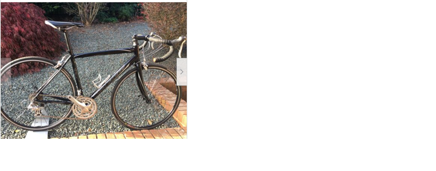

The bike shown below went for just under £125 on its third listing (with the same starting price) just over a month ago and is typical of what can be had around here if you are prepared to wait for a month or two, I search within 25 miles of WR5 xxx which includes some of Birmingham.
This is currently up for £37 and ends in about 6 hours

Just looking at ebay and these 3 popped up next to each other, okay the Sectuer appears to be a bit on the high side price wise (but it is 105 and Kyseriums), they are all modern with STI and easy to get replacements.
Edit - 21 Jan
Carrera TDF sold for £70, Red one for £37 and the Spec. for £200
