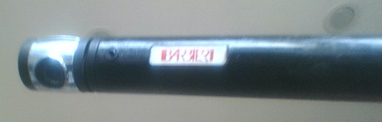

My teeny-weeny one is shown below (Barbieri, which I think was from PlanetX but way not £11, selling on the bay: https://www.ebay.co.uk/itm/195569143139? shared for illustrative purposes only) and is a man(pocket)-sized 150mm long. Finish is carbon weave (so it's carbon as well ;) ). The pumped volume is 92mm x 17mm and (just tested) I can easily (with patience) get a 25-622 tyre up to 70psi, pumping only with my right hand which did get a bit (@presta ) warm ^_^

I was considering a frame pump, but does that still get as hard to pump as the pressure goes up, or is it just faster?
My old frame pump is 510mm long (to fit under/on a 560mm top tube or seat tube). But its swept volume is only 260mm x 19mm - about the same as the 340mm long Airspeed LX in image above.
The energy needed to pump a specified size tyre from grade to (say) 70psi (to compress the air) is the same whatever linear pump is used. The larger the calibre the more force is required for those final strokes (I think).
But the ergonomics of a 'frame' pump (even though of larger calibre) mean it is easier and faster. The number of cycles for a mini-pump means significant reciprocating losses, so less efficient overall.
