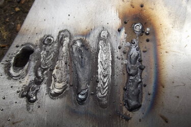

Here's some test welds I did with 1.5mm mild steel and 1.6mm arc rods using the inverter welder.
As can be seen the weld 2nd from right is quite presentable. All the others were carried out with travel speed too high or too low, amps too high or too low or arc gap too big. Just trying out extremes of machine settings and technique give an insight into what will work.
