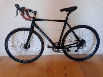

A possible solution, this bike I bought:
Jamis Nova Sport 2015
It's a bit rough at the moment, the chain doesn't sit right, the bottom bracket feels weird and the intricacies of disc brakes still elude me.
But the thicker tyres, drop downs, hoods and the higher handlebars are good.
May take it to the local bike shop see what he makes of it. At the very least I now have some drop down handlebars and 2x8 Claris shifters and derailleur for the other bike. :smile:
Sort that saddle.
