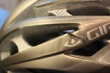

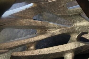

OK here's some pictures.
As you can see and from my description, definitely hit my head. My head was the only contact area with no damage. Helmet1.jpg Helmet2.jpg
Its purely speculation without photos and the helmet to look at but my guess would be that you did a typical cyclist high speed fall in which you rolled and slid on your body and arms and kept your head clear of the ground. Your helmet from your description is cracked. If it had done anything to mitigate an impact you would have seen a circular area of heavily compressed polystyrene. The fact that you didn't (or at least you haven't reported it despite being given the opportunity to) and it was visibly not the case in gaz's helmet photos means your heads probably never hit the inside of the helmet with a force even equivalent to a 12.5mph impact (that being the speed at which you should get bottomed out compression of the foam). You see the helmet is designed to work by decelerating you head slowly over the distance of the foam thickness as it compresses rather than abruptly as the bare head hits the object. That compression is non-reversible so its not that its sprung back, its designed to stay compressed. So no compression means no force had been applied to the outside of the helmet big enough to push it against the head and crush the foam. If the force is that low it is very unlikely to have caused injury if applied directly to the head. Fracture often occurs because a vent of something catches on the way and snaps the polystyrene in two which is very easy to do, unlike compressing it.

Contrast with mine: http://www.flickr.com/photos/coruskate/tags/helmetsavedmylife/ where you can see the polystyrene actually crushed partially instead of just snapping.

Looks like you landed on something proud of the ground?
There's gotta be double entendre in that question lol
Yeah looks that way doesn't it. Its not the best surface so could have been a loose stone or just a stone protruding. Hard to say with all the forces. Glad my soft skull and skin didn't take the brunt of it though.
Whatever damage is on the helmet is damage my head didn't take

I bet you the price of a new lid (with or without the replacement offer) that your skull is made of something less soft than polystyrene ;-)
Yes of course, but that polystyrene still took the knock so my beautiful (subjective) less soft head didn't have to...
