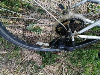

Picked this up at the recycling center for a fiver, with a view to setting it up for weekend tours. Despite being 7 speed (screw on freewheel) it has the low gearing I'm after for Devon hills ( 3 x 7 speed 34T Megarange), front and rear rack bosses.
Plan is to spend as little as possible and use parts from the spares bucket. I'm having trouble identifying the frame, says "Gold Series Aluminium" but it's all steel ( I'm hoping true temper - double butted, hard to tell because the parts are weighty)
Wheels are 36 hole 700c Matrix 550, stainless steel spokes, hubs are nothing special but look serviceable, shifters are Gripshift, the rest is low end Shimano. 32mm Bontrager winter / hybrid tyres.
Parts going on are LX V-brake, green cable outers and green Ritchey mtb grips, Ritchey riser bars, Specialized saddle, trigger shifters, may purchase a quill to ahead adapter and fit a Race Face stem I have spare.
I want to keep the other parts and see how the bike rides before throwing any money at it, see how it does as a general purpose bike for road and the occaisional byway.

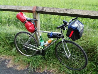

The bike's now built up as a light tourer, tubes, tyres, ahead adapter, hollow front axle, 10 spokes, bearings, brake pads, bar ends and chain were all bought for the build.
I bought two donor bikes (£5 each) and salvaged, Deore rear mech, rear wheel - Mavic A319 / Deore, Specialized ergonomic grips, one Shimano V brake, 8 x 3 speed shifters, and cables.
Riser bars, stem, pedals, seat, post and silver paint all came from my spares.
