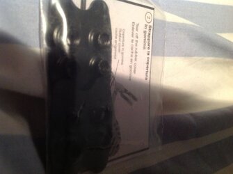

Aren't they? These came in the box with them, and there's a 'remove this bit of sole' part.
Confused.com :smile:
Whoops, I couldn't find reference to SPD in theblurb, and the price was so good I assumed they were just flat soled shoes. I've managed to make myself look a bit foolish then! :blush:
So, to answer your question again, yes, those pedals are great, the shoes ideal and you won't need to order the cleats as they will come with the pedals.
